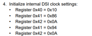

  • Hello Jeshwanth,
    This sounds like it may be related to what is described in section 4.2 of this application note on DSI bringup: https://www.ti.com/lit/pdf/snla356
    Please check that section for information on how to diagnose this potential implementation problem. Also please note that your initialization script should have several extra steps which are described in the power up init sequence section of the datasheet prior to the last line which enables DSI:
    Casey
  • Hi Casey,
    Thanks for providing direction to debug this issue. From 4.2 section I use the resolution mentioned over there. Now display not coming at all, before atleast I use to see the display on Pwr key toggle two times, now nothing.
    Below is my last few lines of my device tree configuration for the panel I am using. In this bold lines I have added after section 4.2 resolution. Anything else u suspect in this configuration?

  • Hello Jeshwanth,
    Please try
    qcom,mdss-dsi-traffic-mode = "non_burst_sync_pulse";
    Casey
  • Hi Casey,
    Tried "non_burst_sync_pulse" still the same. Any other information required from host side to analyse?
  • Hello Jeshwanth,
    I would recommend reaching out to Qualcomm for support on configuring the DSI driver here since we are not experts on that from the TI side. As for 941AS, your configuration looks correct for a basic configuration of PCLK from DSI clock mode where the source would be expected to be in non-burst sync pulse mode and to provide accurate DPI timing per the DSI standard. In terms of debugging the 941AS side specifically I would recommend to follow the flow chart provided in the app note I linked before as it gives a step by step process to narrow down on the problem area quickly and precisely.
