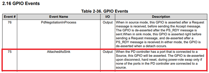

Hi Team,
I would like to ask about AttachedAsSink of GPIO Events.
Could you tell me the delay time (max) from ”VBUS is applied" to "GPIO goes high"?
https://www.ti.com/lit/ug/slvuc05/slvuc05.pdf
I would also like to know the delay time (max) from "VBUS is applied" to "sink current starts to flow".
