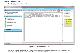

We are trying to do a setup like this.
PC -> HDMI -> DS90UB949 EVM -> DS90UB948 EVM -> Display.
We were able to get the display properly, but the problem is everytime we need to load the configuration files on DS90UB49 and 948. We want to load the settings permenantly on EVMs.
 Could you please provide a way to do that?
Sundar

    The current available EVMs don't have Non-volatile memory that we can use to store settings permanently. But, the Analog LaunchPAD (ALP) software can be used to quickly and easily load the configuration of interest after bootup. The ALP software allows the user to add permanent soft buttons to the Scripting tab so that they can be used to quickly load any configuration of interest. Highlighted below are examples of such shortcut buttons:
    Please refer to the FPD-Link learning center, "6.1 Use of Analog Launch Pad (ALP) GUI to configure the FPD-Link EVMs" video, to learn more about how to do it. In minute 12, the video shows how to add such buttons. Here is the link for your reference:
    https://training.ti.com/use-analog-launch-pad-alp-gui-configure-fpd-link-evms
