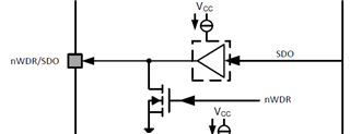

2. nWDR/SDO pin input termination.
It is described as below in the datasheet. In Pin mode(SPI is not used), nWDR/SDO has pull up or high impedance if not driven Low?
Since Vcc=3.3V and MCU IO=5.0V, I concern if there is internal pull up to 3.3V or not.
    This is an output pin whether or not you use it in pin mode or SPI mode. As you stated there is a pull up to VCC. When the watchdog times out, this pin goes low for time of td and then release back to VCC. You have to make sure that your MCU can read a 3.3V signal but I would assume with most MCUs this would be fine.

    I have further question on #2 nWDR/SDO pin.
    When it is configured as nWDR, it is Open drain output and internally pulled up to Vcc=3.3V, correct?
    How much is the minimum VOH?
    Is it possible to externally pull up to 5V if MCU cannot receive 3.3V?
    That is correct.
    There technically is no minimum VOH, since you can pull it up to any voltage you want.
    Yes you can pull it up to 5V.
    Chris
  • How much is the internal pull up to Vcc?
    In other words, I will use Vcc=3.3V version and communicate with 5V MCU,
    In this case how much is the recommended pull up external resistance to 5V external supply
    to overcome this internal pull up?
    regards,
  • I believe the pin is pulled up through an internal current source. You can use a 1K to 10K external pull up resistor. The stronger the resistor the better.
    Chris
