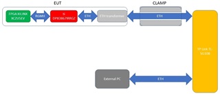

in our machine we have the DP83867IRRGZ as ethernet controller and Xilinx XCZU5EV as FPGA.
We have connect our machine to an external ethernet switch: TP-link TL-SG108 and we have connected a PC to the external ethernet switch. The cable between EUT and ethernet switch pass through the clamp.
During the immunity test we have done a ping command between EUT and external PC, at 1Gbps.
The immunity test was EN 61000-4-4 (burst level 0.5kV (repetition freq. 5kHz), CLAMP on Ethernet cable).
When we apply the burst, the ethernet connection fails, when the burst stops the ethernet connection is restored.The same test @10/100Mbps ends successfully.

  • Hi Diego,
    My thoughts are that this is most likely a board dependent failure. I am going to copy and paste some layout optimization guidelines below! (These are from an app note that will be released online soon.)

  • Hi Lysny Woodahl,
    at hardware level it's all ok, impedance, distance and so on.. We are made the signal integrity analisys before made the boards..
    In order to understand what is the problem, we have done some test and some verifications as explained in the application notes:
    - “DP83867 Troubleshooting Guide”
    - “How to Configure DP838xx for Ethernet Compliance Testing”
    In all test the signals are compliant with the results shown in these application notes.
    We have made some test changing the registers value:
    1. RGMIIDCTL: we have changed the amount of delay on TX and RX signals. The ethernet connection work fine in a lot of configuration of these registers.. When the value of the register fall below 0x33 or exceeds the value 0xEE, the ethernet connection stops. Since the connection doesn't fall with a lot of values of delay, we can say that the RGMII has robust signals..
    2. PHYSTS: by default the chip has autonegotiation on.If we try to disable the autoneg an then set the speed, the link fall and the ethernet connection doesn't resume.. We can't understand this fact..
    Have you got any suggestion in order to investigate about our problem connection?
    Can we check some register value?
    Do you know of a similar problem on this ethernet phy?
    Diego.
  • Hi Diego,
    Could you please confirm that the last three design recommendations are complete in your design? If you are able, can you share your layout design to confirm that these are included in your design. The design will not be able to pass these tests without these recommendation.
