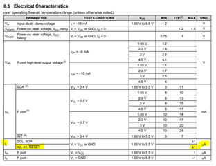

The datasheet for the TCA9538 states (multiple times) that the nRESET pin must be pulled up to Vcc if no active connection is required.
For example:
Is there a reason that nRESET cannot be wired directly to VCC, if nRESET control is not required?

    Could you explain how the resistor limits inrush current?   The datasheet says that the maximum input current for the nRESET pin is 1uA, so even at 5V this pin should have 5MOhms of input resistance?
    I must be missing something!  Something to do with the power supply ramping up changing the input resistance of nRESET?
    Let me know if I'm referring to the wrong thing but I think you are talking about this in the datasheet:
    The electrical characteristics are not requirements of the device, it is simply how the device preforms with different test conditions. What this parameter talks about is the current going into or out of the pin when you only attach power to the device. You can think of it as the maximum leakage current from this pin.
    For a pull up resistor we recommend anything from 1K-10K. This will limit the current going into the pin and will keep your pull up relatively strong.

    The highlighted section you correctly referred to says that at maximum 1uA of current will go in (or out) of the nRESET pin. Therefore, it must have an input resistance in the order of 6-mega-ohms, given that the maximum voltage that can be applied to the nRESET pin is 6V.
    Therefore, I cannot understand how having a 10kohm or 1kohm or any other pull-up resistor in the 10s of kohms range could make any appreciable difference to the in-rush current into the nRESET pin.  The effect of the resistance is neglectable compared to the existing input resistance.  (6Mohms+10kohms is basically still 6Mohms!)
    Therefore, I'm clearly misunderstanding something about how this chip works.  The nRESET pin must be low impedance at some point during the operation of the TCA9538 for there to be any significant inrush current, presumably below Vcc = 1.65V? This operating condition is what I'm trying to understand as presumably the same effect could occur on other pins...
