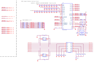

I use network cables to link the both DP83867 board (PING each other ), there is a certain probability of no link phenomenon;  for example,restart again and again over 300 times, there  are about 30 times  phenomenon that  appears  no connection , the issue  is same  in RGMI or SGMI  interface, and the both DP83867  PCB of  boards are same,  the schematic is as below,  I use 3 channel power supply for PHY chip,that is VDDA1P8 ,VDDA1P0,VDDA2P5, the timing :VDDA1P8  is 200ms earlier than VDDA1P0 and VDDA2P5;

    sorry for that , the two interface mode RGMII & SGMII share for you , help me double check ;
    13-SGMII_Gigabit_Ethernet.pdf05-Gigabit_Ethernet.pdf

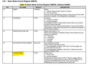

    I configured 0 x 002D register,to write 0 x 4000,but I found DP83867IS has no FLP signal,and I also found there was no reference DC value.
    then I refer to register 0x0000,normal is 0x1140,  abnormality is 0x1940(it goes into power down mode
    I do not know why it goes into power down mode , can you give me some advise or suggestion ?
  • Hi Cooper,
    You can read back 0x2D to make sure that all the FLD modes are enabled. If none are enabled, FLD will not provide us any information.
    Also, my suggestion is that there is a signal on the POWERDOWN_INT pin that is causing the power down. Could you please either check or provide the schematic so we can look into it?

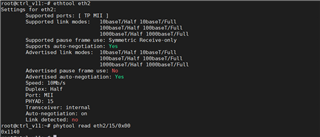

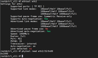

    When the two boards are abnormal during the speed measurement, use ethtool to read PHY status as follows:
    Abnormal board:
    normal board:
    It can be seen from the figure that the power down bit in the register 0000 of the abnormal board is set to 1.

    The power down int pin connected to FPGA GPIO, no control during speed testing and remains high.
    The schematic diagram is shown in the pdf attachment in the previous question. 13-SGMII_Gigabit_Ethernet.pdf
