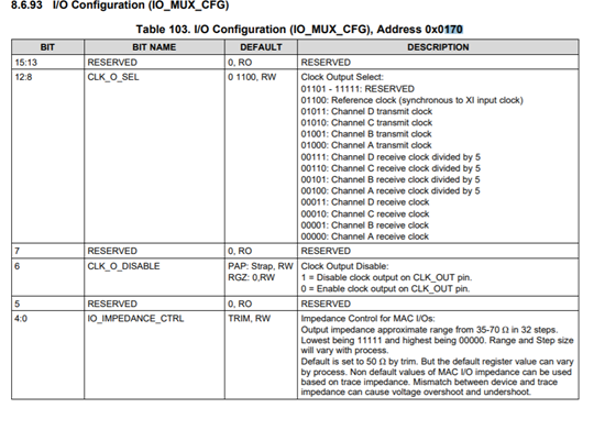

DP83867IR: Can CLK_OUT be set to 125MHz?
Part Number: DP83867IR
Hi team,
            My customer is using DP83867IRRGZR. Ambarella required that their CV22 processor needs 125MHz clock from CLK_OUT pin for RGMII. How to set CLK_OUT=125MHz? I only saw Reg_0x0170 can set CLK_OUT=transmit clock/receive clock.
            Below are the register read for Reg_0x31/32/6e/6f. I see something are disable in Reg_0x32. What are the correct value for these registers?
            Thanks.
            Reg_0x0000=0x1140
            Reg_0x0031=0xac02
            Reg_0x0032=0x0000
            Reg_0x6e=0xc00
            Reg_0x6f=0x3000
