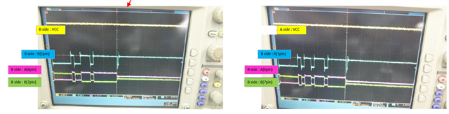

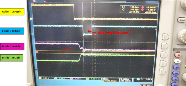

My customer uses the SN65HVD24 interconnected.
Distinguish the two SN65HVD24s from the A side and the B side.
In addition, there is an offset of about 0.6V on the B side because a resistor network circuit for failsafe is added.
My customer has designed the input on the B side to always be at the H level when the output on the A side is disabled, but that is not the case.
The waveform photograph below shows that the R output on the B side has reached the L level when the TX on the A side is disabled (DE = L).
Would you please give me some advice on what caused it?

    Thanks for the detailed explanation. Based on your description and the waveform, this does not sound like intended behavior. Event without the external biasing circuit, the internal failsafe for this device should switch the receiver output to a known state soon after the transmitter goes high-z (DE=L). However, it seems that some ringing or oscillations in the system after this high-z transition is causing the glitch pulse to occur.
    In the scope shots, were the probes for the A and B pins located on the Aside board or Bside board? Because the issue is occurring on the Bside receiver, it would be best to view the signal voltages as close to the receiving IC as possible. Based on the small oscillation we can see on the A and B lines in this scope shot, I suspect that ringing at the receiver crosses the low-level input threshold for a period of time, causing the R signal to change to L for a moment.
    Is it possible to share the biasing circuit used on the Bside? If this is a typical failsafe biasing implementation, sharing the resistor values may be sufficient. Please also share the location and value of all termination resistors in the system.

    The failsafe biasing circuit here looks good and should keep the bus state biased well above the 200mV threshold for RS-485. The differential seen on the waveform is very close to the theoretical offset here. I don't expect this R pin pulse to be caused by an issue in this circuit.
    Please help with some more info:
    • Does this occur on every time that DE is disabled? If not, what is the frequency of occurrence of this R pulse?
    • Does this phenomenon appear to impact all units tested? Or does this appear to only occur with a particular device/board?
    • How far apart are the nodes placed in this setup? How long is the cable?
    • Please confirm that the power supplies for both transceivers is stable during the test.

    Based on your data and description, it looks like the device is not behaving as intended. I'm not aware of any similar issues occurring with this device, so I'm interested to see how this behavior may change based on the characteristics of your system. As this issue appears consistently and is replicable in your setup, I'd like to see what modifications may reduce or eliminate the phenomenon. If possible, please help conduct the following tests to see what impact they may have on the R pulse.
    • Test both nodes when the connection between them is direct (far less than 1m) to see if eliminating the small amount of ringing also stops the pulse.
    • Change the values used for the external biasing circuit. Initially, I suspect decreasing the value of the biasing resistors or increasing the value of the termination resistor would help keep the idle voltage biased further outside of the thresholds.
    • Try replacing the transceiver with a similar RS-485 device such as THVD1450 to see if this stops the issue. If the issue persists, we can assume that the conditions of the system may not be compatible with RS-485 specifications.
       [Higa]
    When the fail-safe bias resistance was changed from 330Ω to 220Ω without changing the terminating resistor, the offset voltage became 0.96V (measured value), and it was confirmed that the problem was cleared.
    My customer has strong questions about:
    In order for the receiving R output to be "Low", it must be Va-Vb> -0.2V or less, but why is it going to be Low otherwise?
    Why does the R output transition to Low even if it is not in the state of Va-Vb <-0.2V when ringing occurs?
    Is it possible to explain these things?

    Your description and understanding of the low-level threshold here is right. Based on the voltages we see on the oscilloscope, I agree that the low-level conditions do not appear to be met, therefore the pulse should not occur. However, the ringing may be more significant than we can see based on these scope shots. Depending on the location on the signal path, the amplitude of the ringing may be different. Even a few mm can be significant with high enough frequencies. Additionally, the relatively long probe cables can attenuate the ringing by the time it gets to the ADC in the scope. The result of all this is that the voltage at the receiver pins may in fact dip below this -0.2V differential that we can not probe without seeing an attenuated signal or modifying the ringing entirely (probe capacitance).
    I'm glad to hear that the fail-safe biasing resistor seems to have solved this issue. This would make sense to help in the above scenario so I agree that if the solution works, there's no need for further investigation. Let me know if there's any further development with this or similar questions.
