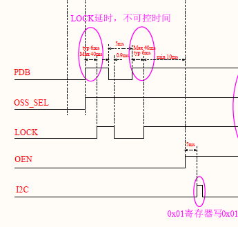

We paired the display with the DS90UB947-Q1 and DS90UB928-Q1 and found the following questions :
1.After powering up the 947 and 928, the 0x0c register of the 947 is sometimes 0x17, sometimes 0x04 (display disconnected), what might be the reason for that?
2.947 and 928 power up shows good, the PDB of 928 is pulled low and then high, and the 0x0c register of 947 is 0x04, what might be the reason for that?
The wiring sequence of the connection may not be a problem, because sometimes it can be displayed normally.
