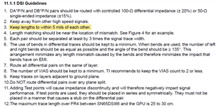

Is the 3rd item in the layout guidelines a inter-pair or intra-pair requirement?
Thanks!

This is the intra-pair skew requirement.
David
