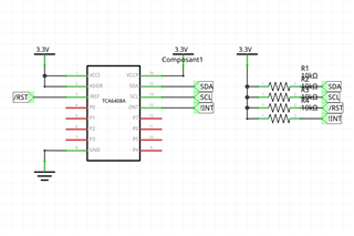

I am evaluating the TCA6408A.

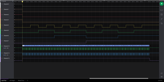

The program resets the TCA6408A, configures the outputs and then writes from 0x00 to 0xFF.
Outputs are pulled-down through 10k resistors. A logic analyser records the I2C signals and the outputs levels.
- It only works when 4 outputs are selected: first four, last four or mixed four.
- When selecting more than four, no output responds.
I haven't find any notice about outputs limitation on the data-sheet.
How to use all the 8 ports as outputs?
