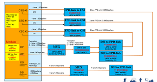

We have a video loop test function with DS90UH941 and DS90UH940.
Does FPD-link signal has minimum length required in FR4 material? In currencies, it's only 3000 mil in our design, is there any I need to concern?
Please help to check the application.
Thanks.

3 inches should not be a problem. We do not have length requirement as long as you follow the high speed best practice and meet our channel specs.

Let me review the block diagram, and I will get back with you by 6/14.

Thank you so much for being patience! I reviewed the block diagram. I do not see any issue because the DS90UH941AS device is only interface with multiplexer such as TC358860XBG and TS5MP645. So, as long as the muxer and converter provide the correct format DSI interface, it shouldn't be a problem.
Hope this helps. Let me know if you have further questions.
