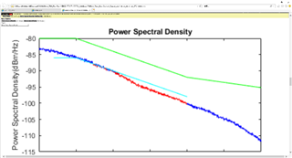

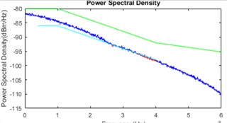

DP83TG720S-Q1: An error occurred in TEST_mode5 (Transmiter Power Spectral Density).
Part Number: DP83TG720S-Q1
Hi TI teams
I conducted a compliance test using the DP83TG720 Media Converter Evaluation Module.
The result is as follows.
Overall, increasing POWER seems to pass the exam.
Is there any countermeasure such as using MMD REGISTER?
