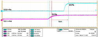

My customer would like to know about a following characteristics how to measure. Would you please answer it?
- measurement point.
- what is triggered signal.

Hi Yasushi-san,
For the output voltage turnon-time, measurement point should be VCC1 and VCC2.
The triggered signal is CC1 which is connected to Rd. You can see below waveform as reference, the waveform just an example.
Thanks!
