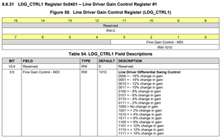

Hi team,
Is there any register can adjust gain of line driver like DP83TC811R/S-Q1 as below? Can the register be used to adjust drive strength to improve EMC.

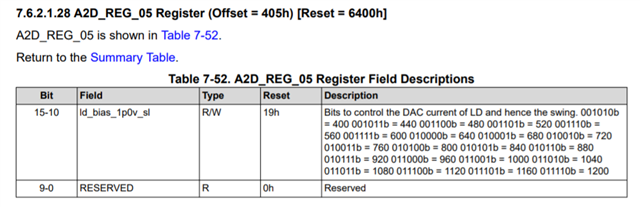

Hello Pengyu Song
Thank you for the query.
Based on your query , i would request you to check A2D_REG_05 Register.
Sreenivasa
Hi Sreenivasa,
Hello Pengyu Song
15:10 = 001010’b = 400mV pk swing;
001011’b = 440mV pk swing; and so on.
