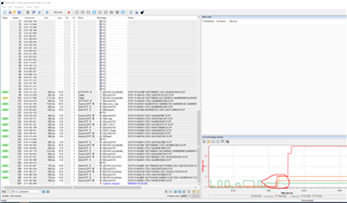

Case 1 (Refer to DRP-DRP-FinalConnect.ccgx attached) starts at 401 Seconds. However, the connection keeps failing until 455 Seconds. It takes 55 seconds to build a valid connection.
While looks into the Type-C state we could see that the initial UFP (Port 2 in this case since it implemented Try.SNK and Port1 implement Try.SRC) side removes the Rd firstly (VBUS removal after). In this case, we could notice the UFP side is doing the removal rather than DFP.
(Zoom in look): I checked every disconnect is caused by Rd removal (No VBUS removal firstly in this case). And I see here’s a Try.SNK state at first Type-C connection. This shall be incorrect since we shall implement no Try on both sides and DPTX shall be DFP/Source preference.
Case2 below shows the same that Port 2 removes the Rd firstly:

  • Hi Steven,
    I have tested with either GUI 6.1.1 or 6.1.2 on TPS65988DH and both are able to connect consistently on all 3 scenarios.
    See attached PD logs.
    Since we have released the 6.1.2, please go ahead and use that.
    If you still see the issue, please send your pjt file.

  • Hi Sir,
    We found out that if we disable USB-C Try behavior on both ports, the connections could be made consistently within 8 seconds. Port 1 originally was designed with Try.SRC and Port 2 was designed with Try.SNK.
    It seems in your case didn't implement any Try behavior on both ports, could you try with the setting above (Port1 Try.SRC, Port2 Try.SNK) and see if you could duplicate the issue?
    We'll try to test with 6.1.2 meanwhile. Thank you!
  • Hi Steven,
    I have tested again using try.src and snk and it's consistently establishing the contract.
    See attached pjt and pd logs with GUI 6.1.2.
