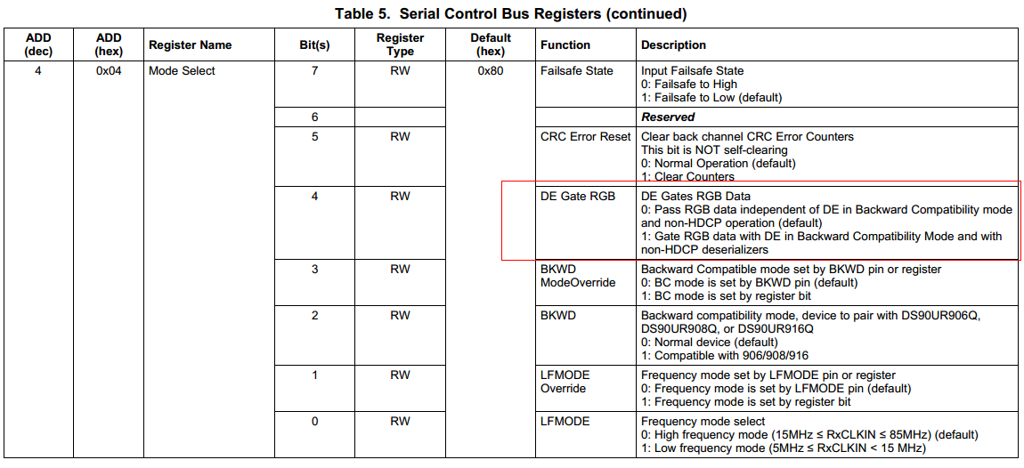

    1. Yes, I suspect it is related to UB928. When the black screen appears, I just set the 0x01 register of UB928 to 0x06 through I2C, and the display will return to normal.Resetting UB927 does not restore 100%.
    2. At present, it is found that black screen is easily triggered when setting Android system. When the black screen is displayed, it is normal for the device to project the screen on the computer through USB, so there is a display on Android.

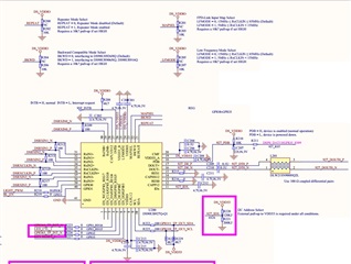

  • 1. The solution we use is QCOM-->UB927~~UB928-->lvds display
    2. When the screen is black, there is always a signal on the RxCLKIN+- of UB927 and TxCLKOUT+ of UB928.
    3. UB927/UB928 are initialized only when the system starts, and there is no I2C operation in the middle.

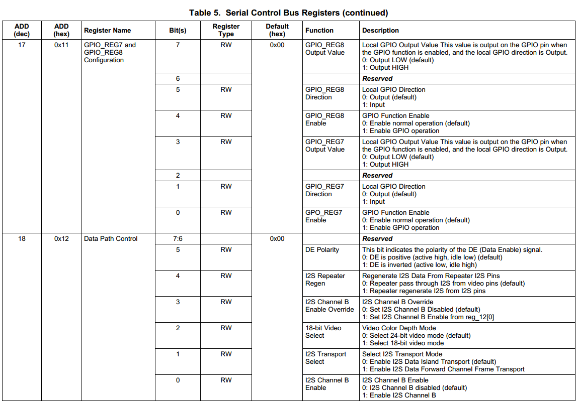

    4. The LOCK pin of UB928 is always high when the screen is black, and the backlight PWM will also change at this time.
  • The backlight PWM uses Enable GPIO control from UB927 (GPIO0) of UB928 (GPIO0)

    Can you please also share your schematics for both sides here for revuew?
    Casey
  • Hello Tenglong,
    I don't see any immediate issues in the schematics or reg dumps that would lead to a black screen here. Can you please check if there is any power supply interruption occurring to the 927 or 928 during operation? Probe the power supplies to the device and trigger the black screen event while checking to see if there is any glitch or dip in the VDD supplies or in PDB. Also, have you ruled out that the problem could be occurring downstream to the 928? Presumably the 928 LVDS is connected to the TCON for the display. Can you please check if issuing a reset to the TCON of the display without resetting the 928 can recover the issue? It could be that somehow the TCON is getting stuck - issuing a digital reset to the 928 will cause the LVDS output to temporarily go away and then come back which may also be effectively triggering the TCON to reset and clear the issue.
    Casey

    Can you try and experiment to set 927 reg 0x12[6] = 1? (Pass RGB). Please give that a try and see if it is able to prevent the issue from occurring
    Casey
  • 1. In my UB927 datasheet, 0x12[6] is Reserved.
    2. I searched for "Pass RGB" in the specification, there are related settings in 0x4[4], do you mean this bit?
  • Hello Tenglong,
    Yes, sorry for the mistake - please try 0x04[4]
    Casey
  • Hello Casey,
    I tested it here, and the screen won't go black.
  • Hello Tenglong,
    Ok, does this mean that your issue is resolved?
    Casey
