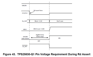

I have some question about internal switch behavior.
Q. Regarding with DP/DM switch, are these switch off during the period of CDP negotiation?
Q. If there is no communication in CC1/CC2 and DP/DM pin, are these VBUS switch stays off?
Yuta Kurimoto
  • Hi Kurimoto-san,
    Below picture is the behavior for power on.
    Q1: After 150ms when Rd assert, DP/DM data switch will turn on. So during CDP negotiation, these switch are on.
    Q2: If CCx don't detect the Rd assert, DCDC will not work. So these switches stay off.
    Thanks!
