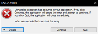

5. Why is it not possible to start the PRBS function using the USB-2-MDIO Tool? Also with the extended register option enabled it doesn't work. This is the error message I get:
In the setup I've selected PHY ID 00 in the software, the EVM is powered by an external power supply with 5 VDC and the connection is verified present with the SQI register.
