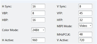

  • Hi Casey:
        Please check the following parameters, Thanks.
  • Hello Chen,
    The above seems to show only one panel spec but you mentioned there are two panels connected through 941AS. Can you share the timing for both panels?
    Also is the above showing only one half of the horizontal timing (one OLDI channel?) It looks like a 1920x720 panel size if I were to double the Hactive. 960x720 is a relatively uncommon panel size
    Casey
  • Hi Casey:
        It's same panel.
        And for your doubt about size,  you're right. It's 1920*720...
  • Hello Chen,
    So you are trying to drive two identical 1920x720p panels? Can you also provide the timing information for the superframe which you are providing to 941AS which contains both images and the 941AS device configuration?
    Casey
