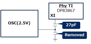

    (Step1) Our original OSC connection is below that is not followed the reference design. That is our mistake.
    It is not work with 100meter cable.
    (Step2) We rework the actual board. It is possible to work with 100metor cable.
                 But it has to make a new Gaber data.
    (Step3) We tried below connection. It is possible to work with 100metor cable.
    Could we turn these capacitor with this connection?
    May TI help us with TI simulation?

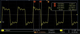

  • Hi Adrian san
    We measure the clock signal at XI with Step3 configuration.
    May we use this setting or turning it?

  • Hi Adrian san
    1. Yes. This configuration is not possible to link up with 100m cable.
    2. Step2 is following connection. But it need new gaber.
    3. Could DP83867IR accept this signal level?
         If DP83867IR is not accept this level, may TI simulate these capacitor value?
         We are nor clear the Internal ciucuit in  DP83867IR.
  • Hi Kosaka-san,
    The connection for step two is correct and the configuration we typically recommend. As a result I would go with this configuration. As for the signal level in step 3, it is too high. The purpose of the capacitors is to divide the voltage of the clock source. With the 16pF removed, the voltage will not be reduced and the clock source will have an amplitude of 2.5V, which is shown in your image. The max voltage level for the XI pin is 2.1V as stated in the datasheet.
    Adrian Kam

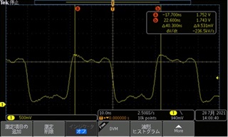

  • Hi Adrian san
    I typo the step number. We tried step3 capacitor value.
    We chaged the capacitor from 27pF to 220pF with step3 configuration.
    It is possible to link up with 100meter cable.
    I attached this clock signal.
    Could DP83867IR accept this signal level and load capacity?
    Kosaka

  • Hi Adrian-san
    Yes. I would like to reconfirm your before advice."The most likely reason is that the configuration in step 1 does not reduce the amplitude of the clock to below the absolute maximum rating."
    I attached our clock signal image for step1 that is high voltage level is higher than 1.5V. But it did not work with 100metre cable.
    Kosaka
  • Hi Kosaka-san,
    Yes, for step 1, you are using a 2.5V amplitude clock signal, and the configuration does not reduce the amplitude of the clock to below the maximum spec of Vosc (which is 1.9V).
    If you are referring the the clock signal image previously attached, then the signal amplitude is higher than 1.5V but it also seems to be higher than 1.9V. Try to get the amplitude to 1.8V, which is what we recommend.
    If you are referring to a new image, then I do not see it on this thread.
    Adrian Kam
  • Hi Adrian-san
    (1) Thank you for reply But I am still not clear.
    Max signal level of Step1 was 1.89V. 2.11v is Peak to Peak value that is from Low signal.  But it could not connect with 100metre cable.
    Is there other point?
    (2)We will make new board that is following Data sheet(Step2) that conbination is 27pF+10pF.
    Kosaka
  • Hi Kosaka-san,
    The Vosc value is peak-to-peak value. So the 2.11 peak-to-peak value in step 1 is too high.
    I look forward to seeing the results. If you still have issues after making the capacitor changes and ensuring the clock signal has a peak-to-peak value of around 1.8V, let me know.
    Adrian Kam

          Does TI recommend 1.8V? or X'tal?
    Please answer for my other quetion too. Because we don't have a time.
    And May TI review our new circuit and Could you accsess with TI Japan?
    Kosaka
  • A.2 : It is difficult to comment the reflection is due to mismatch of capacitor. That's why we want you to test with 1.8V Osc or XTAL to isolate the issue.
    Geet
  • Hello Geet-san
    A3. How about TI validation result(27pF+16pF)? Is there reflection?
    May I kabe an answer for my question1,2
    Kosaka
  • Hello Geet-san
    One week is passed. May I  have a recomended value?
    Kosaka
  • Hello Geet-san
    May I have a TI test result for reflection?
    And we would like to clear the root cause for our original circuit soon.
    Kosaka
  • Hello Geet-san
    We are designing new board now.
    So Could TI provide recommended capacitor value?
    Kosaka
