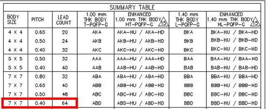

Regarding its datasheet, the TUSB9260 pin pitch is 0.4mm but it is also specified that it meets JEDEC MS-026 which has a pitch of 0.5mm. Wich information is right ?
