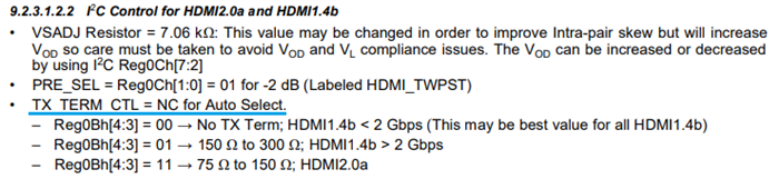

    I would like to ask an additional question.
    1)
    My customer considers doing HDMI 2.0 compliance test with their application and he assumes I2C control.
    Regarding transmit termination, should APPLY_RXTX_CHANGES need to be set?
    The datasheet doesn't refer to APPLY_RXTX_CHANGES so I would like to confirm just in case.
    (datasheet page 46)
    (Configuration Guide page 1-2 )
    https://www.tij.co.jp/jp/lit/an/slla466/slla466.pdf
    2)
    I believe "TX_TERM_CTL pin=NC" isn't required when I2C control.
    Is my understanding correct? Is the following typo?
    Yaita
  • Yaita-san
    The TX_TERM_CTL = NC is the default setting. But when switching from pin strap mode to I2C mode (I2C_EN = 1), the TX termination will be overwritten by Register 0x0Bh[4:3].
    APPLY_RXTX_CHANGES , Self clearing write-only bit. Writing a 1 to this bit will apply new slew, tx_term, twpst1, eqen, eqadapten, swing, eqftc, eqlev settings to the clock and data lanes. Writes to the respective registers do not take immediate effect. This bit does not need to be written if I2C configuration occurs while OE or hpd_sink are low, I2C power down is active.
