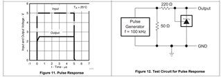

I have an application where I have a working voltage of 3V to 60V (up to 65V preferred) and a max clamping voltage of 70V. It will be used to protect the input of an LMR36506 and an INA229. Is it possible to use a TVS3300 and TVS2700 in series? Or can you suggest another solution with low cost, quiescent current and small footprint that uses an external mosfet? Any circuitry would need to be powered by the rail so it can protect from a sudden transient when otherwise unpowered.
