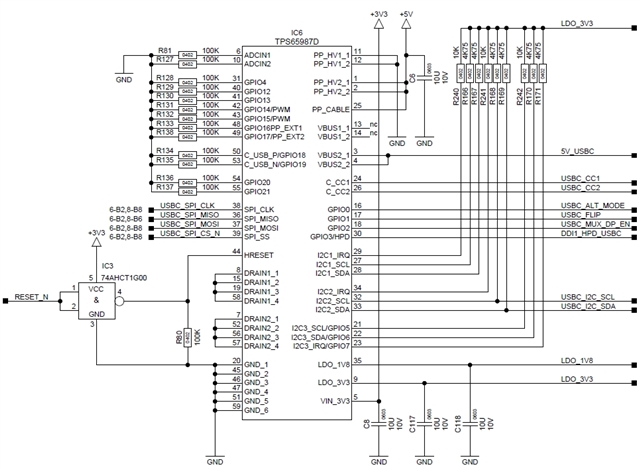

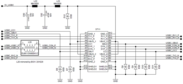

Hi
We us a TPS65987 in GPIO mode to control a TUSB1046. If I connect a USB Stick to my design everything is working as expected, but there is no communication on the CC lines. If I connect the same stick to the TPS65987EVM there is a lot of communication on the CC lines.
Our main problem is, that the DP-Alt Mode is not detected. My CC analyzer only detects "Hard_Reset", if I connect a DP-Alt Mode device.
The schematic is more or less a copy of the TPS65987EVM and the TUSB1146EVM. It was checked by TI but I could send it to you as privat message
