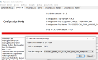

  • related question, i am using
    USB-C-PD-DUO-EVM Evaluation board
    for testing,
    i am connecting the source to sink directly with type-c cable and apply power supply to the sink board, however,  the sink 9v 15v 20v button does not respond, does that mean there is issue with onboard (sink) firmware? if so, can i have the default firmware to relish it?
    only place i found in the application is :
    also i already split the USB-C-PD-DUO-EVM to 2 separate board, and in order to flash sink board, i stack on top of each other and set jumper to SNK
    however, if i use the following: Device > Re-Flash EVM Firmware (Recovery) > and select "tps65987_power_duo_mode_SINK_EVM_flash_image.bin" i get error/SPI error, eventho the setting shows SPI is working fine
  • Hi Allen,
    Yes that's the correct I2C Events option and the Port Control looks good.
    For the default firmware, yes that looks correct and you will be able to flash those project settings. For programming the different boards, I believe there's a jumper to select which board.
    To negotiate the other voltages on the sink side, you first have to push the corresponding buttons on the Source board, this will update the Source capabilities of the board and then on the Sink side, when you press the same button for the voltage you selected on the source board, it will negotiate to that afterwards.
