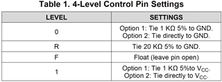

TUSB1044: Difference between tying directly vs via 1KΩ a 4-Level configuration pin to Gnd or Vcc and if the 1KΩ is actually the maximum allowed to tie but anything in between 0 and 1kΩ is acceptable.
Part Number: TUSB1044
On Table 1 (4-Level Control Pin Settings) on page 20 of the TUSB1044 spec. (www.ti.com/.../tusb1044.pdf what exactly is the purpose of Option1 (tie via 1KΩ) vs. Option 2 (directly tie) ?  What happens if it's something in between (e.g. 470Ω)?  Is really what this is trying to say that it's Ok to tie with anything between 0Ω and 1KΩ?  Is it thus preferable to directly tie or at least tie with something lower than 1KΩ?
