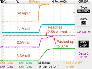

I have a design using 4 DP83869HM's in 2 supply configuration with VDDIO being 3.3V.
Upon power up all 3 rails (1.1V, 2.5V and 3.3V) come up simultaneously.
However, once the 3.3V rail exceeds ~2.7V it starts backfeeding the 2.5V rail through the DP83869HM's (see attached scope shot) eventually pushing the 2.5V rail up to 3.1V. I've verified this is the path the power is taking by disconnecting one DP83869HM from the 2.5V rail and probing directly at its VDDA2P5 pins (pin 3 and pin 9). When doing this I see 3.1V on the pin.
Further, using my multimeter's diode test mode between the DP83869HM's VDDIO and VDDA2P5 pins I get a result showing a 0.2V diode drop, consistent with the above results where the 2.5V rail is pushed up to 3.3V - 0.2V = 3.1V
I'm terribly confused why this is happening as it seems to be deeply wrong behaviour. Obviously it is also preventing my design from working correctly.
I would appreciate help root causing and resolving this issue.

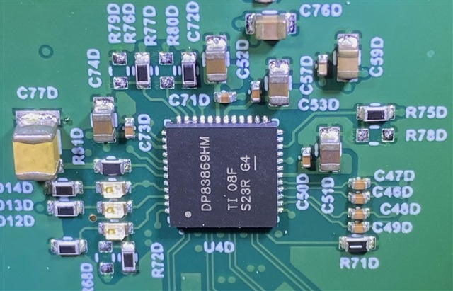

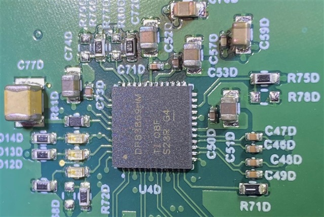

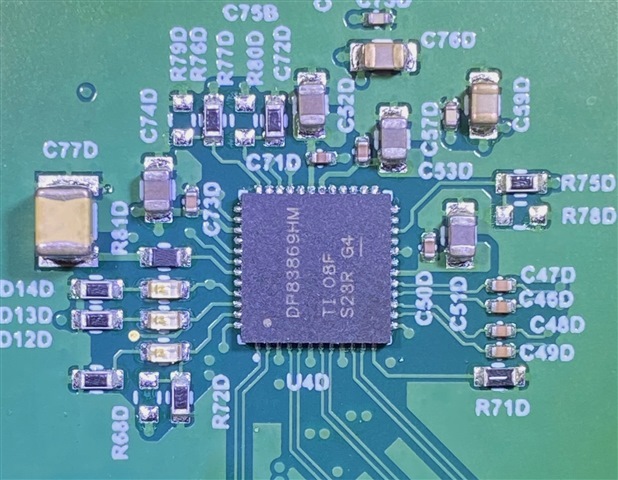

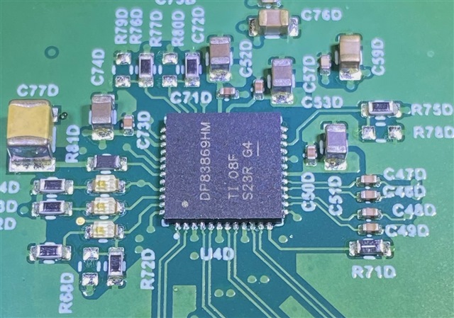

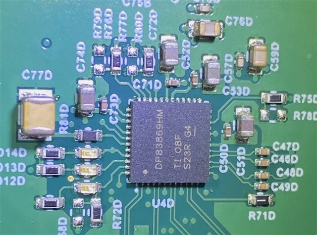

  • I've emailed you the schematic sheet containing the DP83869HM.
    Soldering appears perfect. Please see attached images as an example.

  • To clarify: I measure 3.1V on the DP83869HM‘s  VDDA2P5 pins even when those pins are completely disconnected from anything else and each other.
    By doing this I’ve eliminated any way the rest of the board could be affecting the DP83869HM‘s VDDA2P5 pins, so the issue is definitely coming from within the chip.
    I’ve also taken another PCBA that’s never been powered up and measured the same 0.2V diode forward voltage between 3.3V and 2.5V rails.
    My next step will be to desolder one of the DP83869HM‘s (sadly I don’t have any extra that weren’t assembled on boards) so I can probe directly at the pins of the chip to see this same 0.2V diode forward voltage.
    Can you recommend any other tests I could perform to identify why the chips are acting like this? Presently they’re unusable and are threatening to ruin our whole build.
