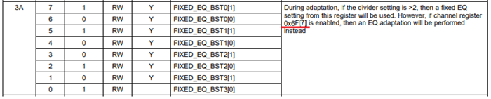

Hi Team,
The datasheet shows the following however 0x6F[7] shows a "RESERVED" bit.
Is the following 0x6F[7] typo?

  • HiYaita-san,
    Correction: the datasheet statement about 0x6F[7] is correct, though the description for this reserved bit is not included. See description below:
    Address
    (Hex)
    Bits
    Default Value (Hex)
    Mode
    EEPROM
    Field Name
    Description
    6F
    7
    0
    RW
    Y
    EN_LOW_DIVSEL_EQ
    1: EQ adaption will be performed for all divider settings
    0: EQ adaption will only be performed for dividers of 1 and 2
