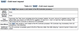

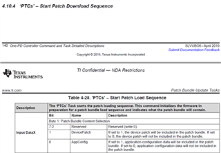

Hi Ghouse,
Thanks for the response! Is there any other way that we can force the 987D to re-load settings from external flash without power-cycling the device? Can I use "PTCs" to achieve this?
Thanks!
Roy
You can use GAID 4CC command to achieve this. You should be able to find this command in the Host Interface TRM
