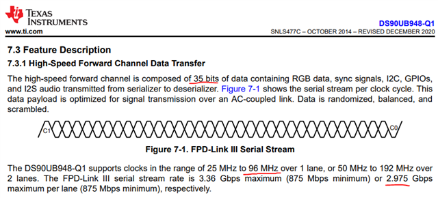

DS90UB948-Q1: question about dual channel maximum Pixel Clock
Part Number: DS90UB948-Q1
I noticed on 948 datasheet that the maximum stream rate is 2.975Gbps per channel, if so, then we can get the maximum Pixel Clock in dual channel model: 2*2.975*1000/35 = 170MHz, but which is different from the 192MHz in the homepage. Is there any problem with this understanding, please? Thank you!
