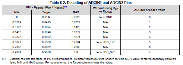

I have configured GPIO0 for ufp_dfp_event_port1 and programmed the same in EEPROM. I can see the direction bit configured as output from the register but GPIO value is not changing even if i connect pen drive in place of charging cable.
ADCIN1 and ADCIN2 are set to 1V5 in EVM , do i need to change ADCIN1 and ADCIN2 settings?
Please suggest steps on toggling GPIO0 with any of the event available in TPS25750D.
B Sandeep.
SAndeep,
ADCIN1 and ADCIN2 being set to 1.5V will configure the part to AlwaysEnableSink mode with I2Cs address of 0x21.
If you are booting from the EEPROM, then I suggest that you set ADCIN1 and ADCIN2 to both be connected to ground VIA a pulldown resistor. This will configure the part into SafeMode with I2C address of 0x21 which is the mode required for EEPROM boot.

Sandeep,
The mode decode is shown in the datasheet, but I have also included a table that shows what voltage is used for each of the decodes.
