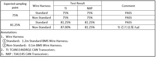

The sampling point of the CAN control module of the main CPU configured in the software is 81.25% (SP=81.25% tQ=16).
When the customer tested the CAN sampling point, it was found that the sampling of the TJA1145(NXP) board was 81.25%.
When TCAN1146 is tested at the same test environment. The sampling point of the TCAN1146 board was tested to be 87.5%.
The only difference between these two boards is the CAN transceiver. Will your CAN transceiver affect the sampling point?

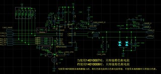

Here is the schematic for TCAN1146-Q1:

    Here is the test result: Could you comment on that and give us suggestions? Thanks.
    Test Environment:
    VH6501 of VECTOR standard test scrip environment, it's common test environment of CAN communication
    After the power is stabilized, the equipment starts to test process. When the sampling point is 81.25% and non-standard wiring harness state. TCAN1146-Q1 will fail. And TJA1145 can pass.

    Here is the schematic and PCB Layout:
    a. TCAN1146DRQ1 is powered by 12V(Pin 10 is connected to 12V Power):
    b. TCAN1146DRQ1 is powered by 5V LDO (Pin 10 is connected to 5V)

    Thanks for this information, the power supply voltage shouldn't have a significant effect on the CAN bus waveform. And I understand that the cable harness is causing the abnormal waveform, what I don't understand is why the sample point of 75% works for both devices, but the 81% sample point doesn't work for the TCAN1146-Q1.
    Typically placing the sample point later in the waveform is more reliable because any ringing caused by cable parasitics will settle later in the waveform. This is why I was asking for waveforms of CANH, CANL and RXD: I am curious to see what is causing the earlier sample point to work but the later to not work for the TCAN1146-Q1. Are the tests the same between the 75% and 81% sample points? Or is something different?
