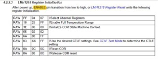

  • Hi Colin,
    LMH1218 has initialization settings as noted in the data sheet and programming guide. Please make sure your customer follows this procedure. Using this procedure, we have not observed not being able to lock.
    Regards ,, Nasser
  • Hi Nasser,
    My customer set as the programming guide.
    LMH1219 differentially outputs to LMH1218, and then LMH1218 is abnormally locked. If touch the series capacitor with hand, the signal will be locked. Or connect a large resistor in parallel between the differential lines, about 500 ohms, and it can be locked, but they don’t know if this will have other effects.
    Thanks!
    Colin
