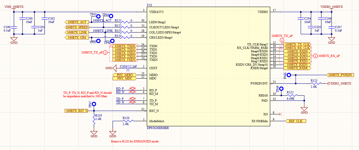

I am using DP83826E with Linux SDK ti-processor-sdk-linux-rt-am335x-evm-07.03.00.005.
As soon as I connect the board to my laptop PC with a straight cable (so I expect the device to work in cross cable mode) I see the link going up and down.
I added some debug information to print the PHYSTS register.
Apparently, the device is trying every mode of operation starting from 10Base-T Half Duplex and then 100Base-T Full Duplex.
Even when the PHYSTS register detects signal and descrambler lock (0x4F15), the link will drop at next polling of the status register.
Which registers should I configure to have the PHY working in a cross cable mode ? (if I connect it to a switch it works!)
