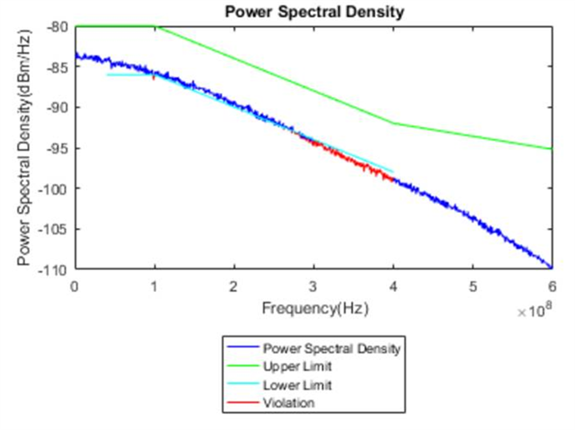

When customer were doing the PMA test, they found that the PSD output by the PHY transmitter was low, as shown in the figure below, which was slightly compressed.
Customers have not been able to find the register to increase the output power from the datasheet. Is there any other ways to increase the output power of the transmitter?
