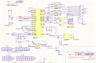

  • Hi Krzysztof,
    Could you provide a schematic for review?
    Lucas
    All information in this correspondence and in any related correspondence is provided “as is” and “with all faults”, and it is subject to TI’s Important Notice (http://www.ti.com/corp/docs/legal/important-notice.shtml).
  • our schematic is above. We dont have strap on RX_CTRL pin, but we clear it manually by mii interface.
    Clock for GTR bank is 125 MHz.
    Thanks for any suggestions.
  • Also we have reversed polarity on TX line. We write to reg 0x01D5 : 0xF502 to change polarity in DP.
  • Hi Krzysztof,
    We're taking a look at your schematic and will get back to you by Tuesday.
    Lucas
  • Hi Lucas,
    We have achieved communication. It was polarity swap on TX line (RX for XILINX). We changed it registers in xilinx and didn't change on DP.
  • Assuming, with good strap configutation and no polarity swap, DP83867 should work without any code modyfications.
