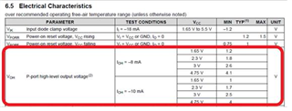

Datasheet show IOH characteristics as below
But blow graph shows different performance
e.g. With Vcc-Voh = 0.4V(3V - 2.6V), Ioh should be about 17mA at 85C. But above characteristics shows 8mA. Which data should be correct?

Nagata,
Clemens is correct. If you have any more questions please let us know.
Kenneth
Could you please let me know the voltage drop when Vcc=1.65V and Ioh = -1mA and -0.1mA?
I would like to know if the output can achieve over 1.4V in this condition.
Nagata.
For small currents, the output behaves linearly; see [FAQ] What is the output voltage (VOH or VOL) when the output current is X or the supply voltage is Y?
So at 1.65 V, for −1 mA, the maximum voltage drop is (1.65 V − 1.2 V) / 8 ≈ 0.056 V; for −0.1 mA, 0.006 V.
