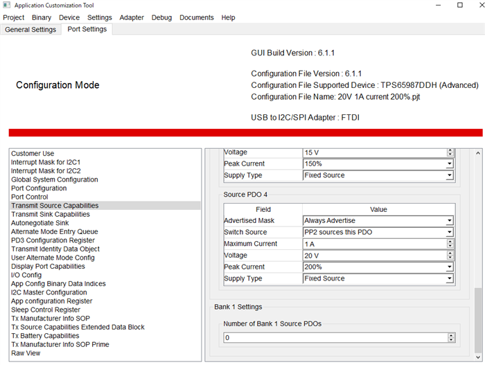

I would like to ask about OCP (overcurrent protection) of TPS65987D.
My customer set Source Capability as the following with TPS65987EVM that is configured as DFP.

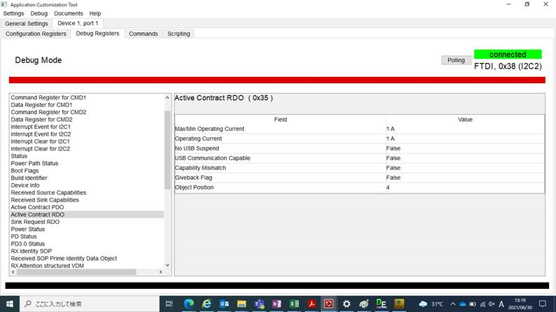

When connected to one PD Sink, he confirmed 20V/1A contract is achieved.

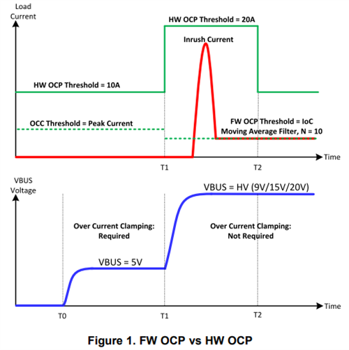

Then he increased the load current at VBUS (20V) on purpose, the cutoff (FET open) occurs around 1.2A.
Is it a normal function of TPS65987D?
I expected the cutoff occurs around 2A because Peak Current is 200%.
