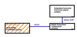

We use TI RS232 transceiver  solution TI/MAX3243EIPWR and we measure power consumption of each state.
There is no RS232 device connected.
(1)Short Idle:110.5mW
(2)Modern Standby:114.016mW
Please refer below TI/MAX3243EIPWR, there is a great deal of difference between Auto-powerdown disabled(No load) and our measurement.
Does it need to to any setting form EC?
Below is our block diagram.
Thank you.
Thank you.

  • Hi, Chris,
    1.It doesn't connect test RS232 device.
    2.There is no other device to share with the power rail.
    3.How to measurement:Please refer below schematic, we cascade a current meter to below yellow power path.
    Thank you.

  • Dear CHris,
    1.Our current design:
    (1)VCC=5V,Forceoff_bar=Forceon=VCC
    (2)Dout and RIN are floating.
    2.
    (1)I try to  pull Din to Vcc. The power consumption is the same.
    (2)I try to  pull Din to GND. The power consumption is the same.
    Thank you.
