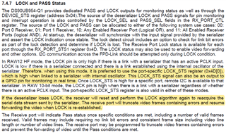

DS90UB954-Q1: LOCK pin output with or without PCLK signal to serializer
Part Number: DS90UB954-Q1
Used in combination with the DS90UB913 and the DS90UB954–Q1.
When using the DS90UB954 Q1 in the RAW12 HF mode, it was noted on the data sheet that the LOCK pin is high only when a active PCLK signal is input to the DS90UB913.
However, after the PCLK is stopped, the LOCK becomes low once and then returns to high.
What are the possible causes of this behavior?
