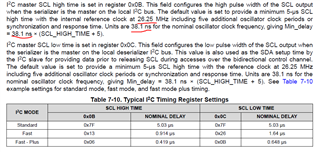

DS90UB953-Q1: Consideration of I2C speed calculation.
Part Number: DS90UB953-Q1
Hi team
When I support customer for I2C speed of UB953, I have question in datasheet description.
as data sheet, it needs to consider 38.1ns as an unit for SCL high/low time calculation.
if customer use synchronous mode/25MHz osc, this unit also is also changed to 40ns from 38.1ns?? or it always 381ns as a unit??
