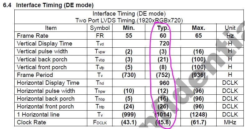

Hi team,
customer use 948 pattern with internal clock to do test, the panel is 1920*720. they found with the same panel, one 948 will have black issue, but others can display normal.
below is ALP configure:
we want to know what's the internal clock parameters of 948? the Appnote only show it is 140M osc, why these two difference 948 have different result?
can you share more information about this? thank you
