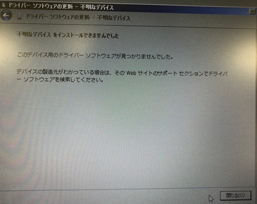

My customer is evaluation tusb4020b. When they are using this hub to connect to a win7 PC, it is identified as an unknown device. The customer reinstalled the driver, but no use.
For other OS like win10, it can be identified. Thus we are considering if it is due to the  HUB internally.
Could you please tell me how to solve this problem?
Zeming
  • Hi Zeming,
    Could you give some more detail on how the Hub does on connect? What is the status in the device manager or USBTreeView? TUSB4020BI uses default USB Hub driver in both Win 10 and Win 7 PC.
  • Hi Malik,
    Below are the captures of device manager. It is descripted as "不明なデバイス" (unknow device in Japanese).\
    And the property of the unknown device shows that the driver is not installed (error code 28).
    When we tried to install the driver, it failed.

  • I will retest in the lab tomorrow, can you provide the USB host controller driver version too?
  • Intel(R) USB 3.0 eXtensible host controller
    Version: 1.0.7.248
  • Hi Zeming,
    we will look into this and get back to you as soon as possible.
  • Hi Zeming,
    That driver version is older and has some known errata with USB 2.1 compatible hubs, can you update your driver?  I am not able to revert back to this version in my lab.
    JMMN
