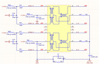

I'm using the DP83848I for my MCU ethernet application. I'm getting timeout response from command screen, but ACT and LINK LEDs active. What should I check first ?

You can try reading registers 0x0, 0x1, 0x10, and 0x11. Is RX_CLK active and what is the frequency? Is CLKOUT active and what is its frequency?

We succesfully read the registers. When I remove the ethernet transformer, I can ping the MCU but with transformer I couldn't ping the MCU. Could you please check the schematic of the magnetic side ?

You can try replacing the ferrite beads with 0 ohm resistors and see if this helps. Can you please provide the values for the registers I listed above?
