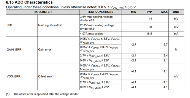

TPS65994AD: ADC features on GPIO4 and GPIO5 pins
Part Number: TPS65994AD
The datasheet does not provide the ADC full scale voltage range, reference voltage and input buffer characteristics when using GPIO4 and GPIO5 as ADC inputs.
- Can you please help us with enlightenment please?
Thanks.
