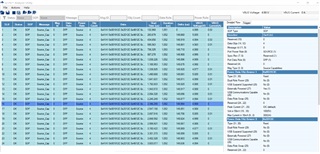

We log the CC protocol by Cypress CC analyzer.
We found CC analyzer just log CC protocol from Type C adapter and TPS65994AD never respond any information.
PD FW look like success load to PD in PD check tool.
