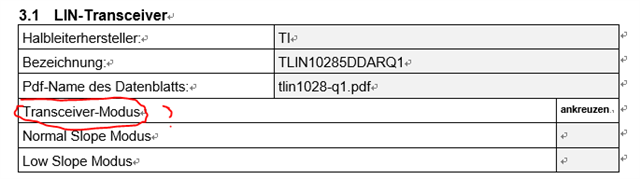

Hi Team,
Could you please kindly help to confirm what is the slope mode of TLIN1028, it is normal slope mode or low slope mode? Thank you very much for your support to confirm.

Hi Eric,
Yes, we could see there has slop control description in datasheet. and following table shows the information which customer need.

Jie,
I'm not sure where the first screenshot is, but the block diagram is just showing the part of the IC that shapes the rise and fall time of the LIN bus waveform to help with EMC. This device has Normal, Standby, and Sleep modes, slope mode doesn't exist.

Hi Eric,
As you mentioned the device could shape the rise and fall time to help with EMC, so if there has any more detail information about the rise and fall time range? Should it fast or slow? This would be the point we want to get, thanks a lot for your time to confirm again.

Jessica,
The rise and fall times are listed in the switching characteristics of the datasheet. This isn't something that is controlled by the user, it is all done automatically, internal to the transceiver.
