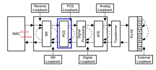

Hi , Experts  :
as title description.
Our SoC (TDA4) use RGMII to communication with DP83TC811.
I set DP83TC811 works in PCS loopback mode, T1 cable disconnect, debug message show successful works in PCS mode.
[MCU2_0]    553.229656 s: EnetPhy_tick: [enetphy.c] PHY 0: LINKED
[MCU2_0]    553.229733 s: EnetPhy_getPhyRegCaps: [enetphy.c] PHY 0: BMCR 0x2100
[MCU2_0]    553.229821 s: EnetPhy_getPhyRegCaps: [enetphy.c] PHY 0: BMSR 0x0065
[MCU2_0]    553.229909 s: EnetPhy_getPhyRegCaps: [enetphy.c] PHY 0: BISTCR 0x16 -> 0x0104
[MCU2_0]    553.230003 s: EnetPhy_getPhyRegCaps: [enetphy.c] PHY 0: xMIICtrl 0x17 -> 0x4241
[MCU2_0]    553.230087 s: EnetPhy_getPhyRegCaps: [enetphy.c] PHY 0: PHYRCR 0x1f -> 0x0000
[MCU2_0]    553.230120 s: EnetPhy_tick: [enetphy.c] PHY 2: LINKED
[MCU2_0]    553.230205 s: EnetPhy_getPhyRegCaps: [enetphy.c] PHY 2: BMCR 0x2100
[MCU2_0]    553.230293 s: EnetPhy_getPhyRegCaps: [enetphy.c] PHY 2: BMSR 0x0065
[MCU2_0]    553.230382 s: EnetPhy_getPhyRegCaps: [enetphy.c] PHY 2: BISTCR 0x16 -> 0x0104
[MCU2_0]    553.230472 s: EnetPhy_getPhyRegCaps: [enetphy.c] PHY 2: xMIICtrl 0x17 -> 0x4241
My question is :
Does it mean RGMII interface also have TX/RX test data stuff to DP83TC811?
Is RGMII interface works?
Many Thanks
